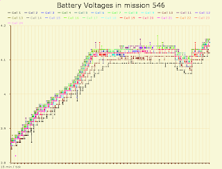

At one of my previous jobs, we had a homemade 1.5kW battery that was made of 648 (yes, six hundred and forty eight) LiPoly 18650 cells: 24 supercells in series, each cell being 27 batteries in parallel. I do not recommend this setup. The cells within each supercell will charge evenly because they are in parallel, but the series cells do not. Here's an example of what the supercell charges looked like when we serviced the battery and each supercell was equally charged (ours were 3.7V min, 4.2V max):
Mission 456
As you can see, they mostly discharge and charge together -- you can see the point at which we plugged in the charger. A few testing days later, one of the cells began drifting apart:
Mission 546
Eventually, they look like this (what it looked like before servicing):
Mission 394
The moral of the story is that using many cells in series doesn't guarantee even charging, because each cell has a slightly different capacity. Using cells in parallel is better because it keeps their voltages equal.
For your particular case: if you don't charge all 4 cells in parallel, make sure that you monitor the voltage of each set of cells in the series -- one parallel pair will have a higher voltage than the other parallel pair. Don't discharge them below the minimum rated voltage of the low pair, and don't charge them above the maximum rated voltage of the higher pair. The difference in voltage between the two sets of cells will impact your available operating time, so it will make sense to manually balance the voltages (using 3.2V parallel charging) every so often.
