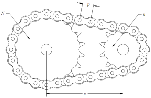

You can use a belt or chain transmission too. Then you need to attach a pulley or sprocket to the valve axle.
Chain and sprocket transmission
chain and sprocket transmission
Synchronous belt transmission
A possible problem with these two option is the lateral force the transmission could put on the valve shaft, as it has not made to support this, it probably will wear. One way to overcome this is to use a shaft coupler to a bearing with the transmission, so the lateral force will be supported by the bearing.
